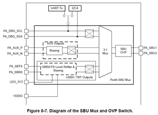

Hi AE,
        Since the DP Aux_N and  DP Aux_P will pass through PD to the HBR.
        I’m concerned that in TBT mode, externally pulling SBTX and SBRX to ground might cause SBU pulled to ground.
        1. Should PA_SBTX and PA_SBRX be pulled low or floating?
        2. Regarding PB_DBG_SDA/SCL, they are connected to the 1.8V system, so we pull up to 1.8V in the external circuit.
            2-1. Does the 1.8 V system need to convert to 3.3 V through a level shifter ?
            2-2. If Debug Access Mode is enabled, PB_DBG_SDA/SCL should not be pulled low, right?
            2-3. If I am not using them, I can pull up to 3.3V or leave them floating, correct?
