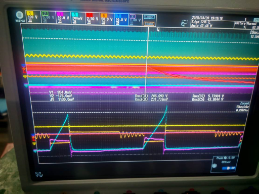

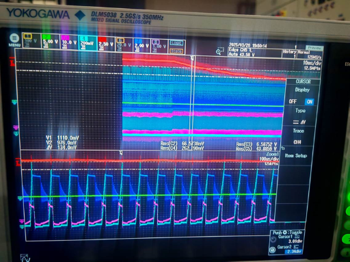

Customer feedback that UCC28740's duty and switching frequency will reduce under heavy load condition, during this time, it can be tested that CS pin voltage is 0.936V~1.1V, exceed the Vcstmax. Would like to check with you whether this is a normal behavior? And could you please help explain it to customer more clear? Thanks.
