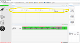

Q3) How can I check the actual measurement values ​​(voltage, current, SOH, etc.) of BQ35100 in bqStudio?

    3-You can view ram data in the register tab.
