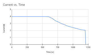

  • Hello Christian,
    I have recorded the charge profile of the battery. I’m attaching the corresponding graphs so you can review the charging behavior visually. I’ve also included the raw data tables in case you would like to analyze the values more closely.
    Please let me know if you notice anything unusual or if you have any suggestions based on the results.
    Battery_Test_Data.pdf
    TICSC
  • Hello TI CSC,
    Should I try replacing it with another of the same value just to check if the issue lies there, or is it a matter of modifying its value?
    This might help. R25=909k, R28=100k
    What is the VFB voltage when the battery reaches the max charge voltage?
    Christian.
