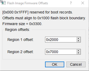

  • Hi Chris,
    1. Does the pjt file you sent is a file for burning through the programmer?
    2. I didn't succeed follow your steps. I did: New project -> 987DDK -> DFP and then I didn't find the number of Source capabilities.
    Is it possible we could contact on teams and there you can show me where exactly you choose the right parameters for Source mode?
    Ohad

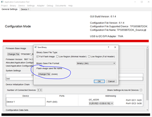

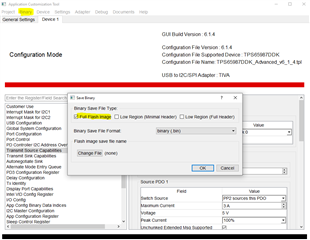

  • Hi Ohad,
    Once you have followed these steps, select Binary->Save Binary.
    Save a "Full Flash" binary to generate the binary needed to load to the SPI flash.
    Thanks and Regards,
    Chris

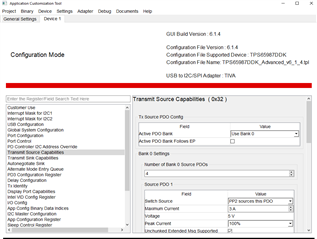

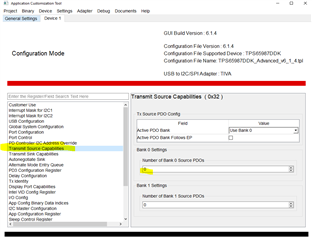

  • Hi Chris,
    Thanks for the answer. A few more questions:
    1. If what I need is 15v at the max then, setting the number of source pdos in Transmit Source Capabilities to 3 is better right ?
    2. I then have gotten this, shall I change there anything?
    3. Are there any more parameters beside? I got this comment - you didn't tell regard that :
    Ohad

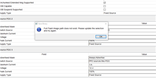

  • Hi Ohad,
    Yes
    No, leave as default and genearte by clicking OK
    You need to select a save location and file name
    Thanks and Regards,
    Chris

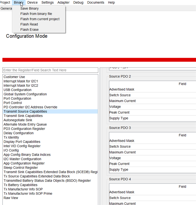

  • Hi Chris,
    I have followed the steps above and right now it doesn't work.
    I found that under binary there are some options:
    If I use a programmer that on the one side is connected by USB to my Leptop and on its other side translates to SPI and then connected by SPI connector to my board with the Flash and the TPS65987DDK, shouldn't I choose "Flash from binary file"  ?
    Ohad
  • Hi Ohad,
    The steps I provided will generate a full flash binary and save it on your PC. Once you have the binary, you need to use your programmer and it's software to load the binary to the SPI flash.
    The "Flash from binary" option is only meant to used with the EVM. It will take a binary and load it to the EVM either through the EVMs FTDI or TIVA interface.
    Thanks and Regards,
    Chris
  • Hi Chris,
    Thanks, I did exactly the steps you provided and then using the CH341A programmer and its SW I programmed the bin file on the EEPROM W25Q80DV, received indication of "Program successful" but still after shutting down the power and then turn it on, I measured the output voltage on VBUS1/2 and measuring showed '0' instead of 15v as was expected after connecting the Type-C connector.
    Ohad

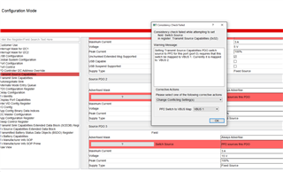

  • Hello Aya,
    I have urgent issue and I can not wait till Chris come back from his vacation, specially that he didn't give me the needed required help.
    I asked for a video conversation since the example he gave me doesn't work.
    I'm now starting figure what might have made that not working:
    I connected it on board in a way that PP2 is connected to external 15v and shall be mapped to VBUS2 which sources this 15v to the Type-C connector:
    According to the error shown above it seems I need to work with PORT 1 instead of PORT 0 in order to be able to map PP2 to VBUS2.
    I'm not succeeding doing that.
    Please contact me to show me how to config it on the GUI.

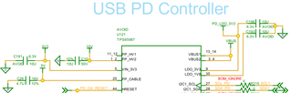

    It sounds like you figured out the original issue regarding flashing. This new issue seems to be an issue with the way you are using the part.
    From the image of the schematic you shared, it looks like PPHV1 is floating, and PPHV2 is connected to a 15-V bus. You have no way to supply the initial 5-V USB-C default contract that is required.
    How do you plan on supplying 5-V and 9-V source contracts?
    For initial testing, if possible, I would recommend removing the 15-V bus and tying it to a 5-V bus to make sure you can at least see 5-V negotiated on VBUS.
    Typically (as with the EVM), the PD controller uses GPIO to control the feedback of the power conversion used for sourcing to supply the desired output voltage.
    From what you have shared, the key issue seems to be the lack of a 5-V source for the default contract.

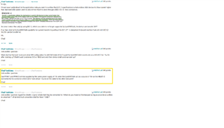

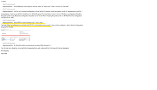

  • Hi Chris,
    I bring here quotes with Aya who was the one who answered me here in E2E 10 months ago while I was doing the design of my Battery board.
    What you just mentioned now regard connecting 5v for source on PP HV1 was never mentioned by Aya! On the contrary, he told me something totally different when I asked him regard PP HV1. He said that it can act only as a "Sink" which I don't need in my application and therefore it was left unconnected:
    In addition, in other detailed post specific to that issue, Aya wrote me that 5v comes from PP_Cable pin and that is how I connected the circuit and built the board.
  • I think we discussed the issues at hand, and the conclusion was that a 5-V supply into PPHV is need for the initial default Type-Contract.

    I really think it is a loading issue and not a program issue. I'm saying that since the SPI flashing tool returns success after burning the flash and also when reading back its content after flashing and comparing to the original file using "Beyond compare" tool the two files are exactly the same.
    I want to check for next steps if may be the PUs resistors I put on SPI which are 4.7k may be too high though it is very common to use 4.7k for PU. I think it may have some bad effect on the signal because of the SPI loading frequency.
    Ok, let me know what you can find out. I'm not too experienced with SPI communication so I may not be able to help too much here.
