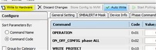

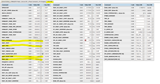

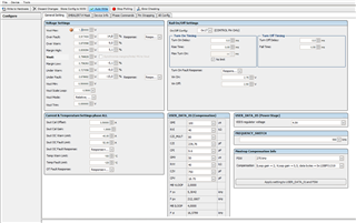

  • You can change the Vout by adjusting the resistor divider at the VSEL pin, or you can modify it via software using PMBus communication with the TI FUSION GUI.
    Yes i have tried to over write but it dosent work, it shows on the GUI that i have changed but when you go to monitoring+in reality it dosent work?
    how to figure out this problem?
    Maybe i am using the wrong steps?
  • Hi Sal,
    Based on the screenshot you've shared, you've only changed the VOUT_MAX, which is the command to set the upper limit on the output voltage.
    The commands you want to use to change the output voltage would be VOUT_COMMAND and VOUT_SCALE_LOOP (if necessary), which is the section I highlighted below:
    You can also access these registers in the tab "All Config." You can also set VOUT_MIN and VOUT_MAX to set the lower and upper limits on the output voltage to prevent the user from accidentally setting the output voltage outside the range.
    Once you change the setting, click "Write to Hardware," and Vout will change.
    If you need to, please reach out directly, and I can go through the steps with you via call.
    Thank you,
    Tomoya

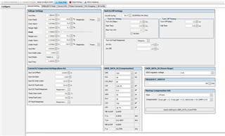

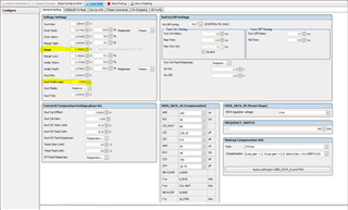

  • Thanks , just one last thing the maximum Vout is 1.5v why is that? or i have to change some other parameteres?
    I am using the same chip using our design and we managed to go for more Voltages
  • Hi Sal,
    The VOUT_MIN and VOUT_MAX values are set to 0.5V and 1.5V, respectively. This is due to the VSEL pin strap resistors on the EVM, which are connected to AGND with a 14.7 kOhm resistor with no top resistor in the resistor divider (Resistor Divider = none).
    If you want to increase VOUT_MAX (for example, to 6V), you need to write the new value to VOUT_MAX. To store this value in non-volatile memory (NVM), either write "STORE_USER_ALL" or click the "Store Config to NVM" button in the TI FUSION GUI.
