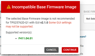

I want BASE binary Image for TPS25762-Q1 F411.04.01 to configure in GUI .Please let me know where i can get it,
Hi Aditi,
Please check the design resources page. You may be prompted to request permission first.
https://www.ti.com/secureresources/TPS25772-Q1-DESIGN
Eric
Hello Eric,
Thanks for support. I can see full flash binary file .but gui is asking for low level binary image.
Let me know how do I get that.
Aditi
Aditi,
The folder contains an .exe installer that must be run to extract the low region binary. It will save to your desktop by default.
Eric
