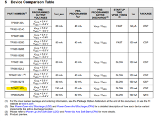

We are evaluating the TPS65132S and would like to confirm whether it meets the following voltage and current requirements for two different applications:
A  Requirements:
  • VSP: +6V ±0.1V, Current: 35mA
  • VSN: -6V ±0.1V, Current: 40mA
B  Requirements:
  • VSP: +5.7V ±0.2V, Current: 100mA
  • VSN: -5.7V ±0.2V, Current: 100mA
Could you please help confirm:
  1. Whether the TPS65132S can support both sets of specifications?
  2. If there are any limitations or required configurations to achieve these outputs?
  3. If TPS65132S is not suitable, is there a recommended alternative that can meet these requirements?
