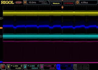

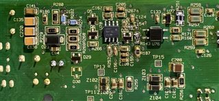

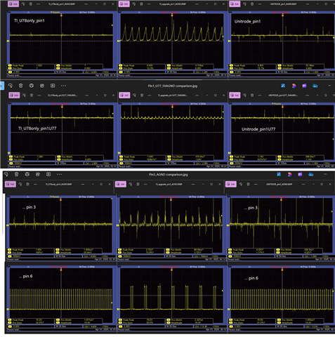

We use IC UCC28C43DR version for many years without any issues.

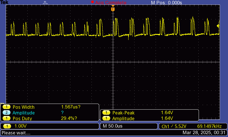

We have ordered new batch in JAN-2025 and we have encountered problems with output voltage → the wave form is not stable (flat), see enclosed pictures as reference.
Old version of IC: with marking UNITRODE is working fine.
New version of IC: new TI marking (refer to PCN#20211123004.0) → output voltage not stable

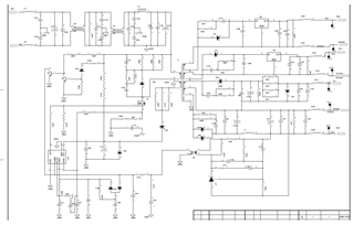

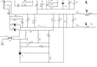

Please see enclosed schematic of application (nothing except IC was replaced) when we have observed problems with output voltage.
Based on TI nothing was changed just the marking.
See below 5V wave of problematic IC
Could you please explain the difference?

    Please provide all the circled components values.
    Also, please provide opto CTR value, please confirm TL431 is used, and output = 5V
    We need these to help adjust the design to adapt PCN device COMP max source current 5.5mA
    Please see below
    Output 5V

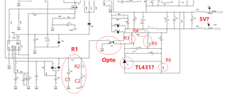

    I will have a look and provide the changes needed.
    COMP source current needs capable of max 5.5mA for PCN devices. You need to have the below changes.
    -  R1, short across
    -  R4, change to 240 ohm
    R4 = (Vout - Vref - Vopto)/(5.5mA + 1.1V/R3) = (5V-2.5V-1.1V)/(5.5mA+0.23mA) = 240 -ohm
    -  Remove C1

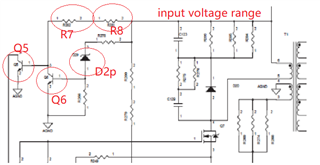

    I also noticed the below circuit is on COMP so I also need to change these circled. Please provide their values and part numbers. Also, what is the input voltage range which is required to help make chaanges.
    Please see below table with requested values
    equested Ours Value
    R7 R282 56 kOhm
    R8 R281 56 kOhm
    Q5 Q5 MMBT4401
    Q6 Q6 MMBT4401
    D2p D29 BZX84-C3V9
    Note, that Input Voltage range is 19-60V.

    It is due to the COMP source current max changed to 5.5mA due to not a datasheet specs.
    R7 and R8 = (R282 and 281), total 112k-ohm needs to reduce to total about 85k-ohm, in order to turn on Q5, assuming Q5 hfe = 25 based on its datasheet.
    Please test my suggested values and if still see problems please let me know.
    Requested changes were performed → 5V output is even worse than before.
    See enclosed wave forms

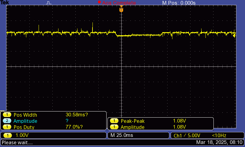

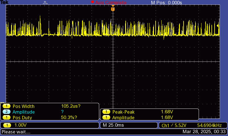

    It looks there are several 5V output, which 5V waveform you show in your message?
    Waveforms are the same, there are 2 different time bases - for comparison:
    - 50us
    - 25ms
    The waveform is worse than before.
    I hope it's clear now.
    Any suggestions?

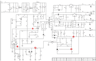

    Please use the regulated 5V for debugging at this time, i.e., the 5V with the below.
    Please provide a better resolution circuit (prefer in PDF) for better communication.
    Please measure the red dots waveforms.
    From all support so far, the changes I asked similar to other designs, after made, the designs come to work right away. I am not sure why not this design. So need to check these waveforms to find out.

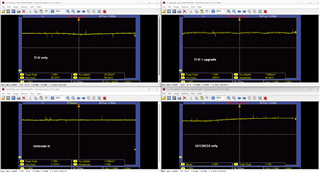

    You labeled 1 to 5, but in your waveforms you showed pin 6 - what is pin 6? Is pin 1 in your waveforms number 1 you labeled in the circuit?
    Does "upgrade" mean the circuit after change with my proposed component values?
    It looks you compare the three - please explain each waveform ?
    TI_U78only_pin1_AGND.BMP - TI unit, U78only (?), pin1 (?)
    Please provide all waveform explanations to help understand.
    Are these waveforms from no load test?
    measuring point numbers are just for my information,
    PIN1, PIN3 and PIN6 are pins on IC U78 - UCC28C43 primary side
    AGND - primary ground
    5VA, 5VAGND, PIN1U77 are measuring points on 5V output, respectively secondary side
    "UPGRADE" means all of your suggestions implemented in circuit.
    TI_U78only_pin1_AGND = only UCC28C43 replaced (all other values are untouched) and waveform is measured on PIN1 of U78 against AGND
    TI_upgrade_pin1_AGND = new TI IC and new suggested values implemented, waveform measured on PIN1 of U78 against AGND
    UNITRODE_pin1_AGND = "untouched" unit, waveform measured on PIN1 against AGND
    All measures were provided under load, 5V feeding LCD display with backlight, some IC as VCC, ..., but the load is always the same.
    Best regards
    Michal
    It looks the test results without "UPGRADE" are quite the same as Unitrode. So let's remove all my suggested changes.
    The below is from your test results - comparing left to right, they do not make meaningful differences. Please add 5VA_5VAGNF from TI and Unitrode to this to help understand.
    Yes, difference between "TI no upgrade" and Unitrode is very small, but there is visible backlight blinking of LCD, respectively small contrast changes
    you can see 5VA against 5VAGND comparison.
    We also tried "upgrade" IC to UCC28C53, and we got same results as with TI UCC28C43.
    Michal

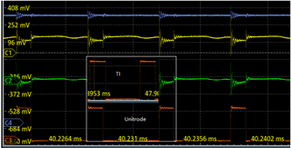

    Please capture the waveforms of "5VA", "U78 pin 1", "U78 pin 6", and "U78 pin 3" in the same picture and in the same time frame since "5VA" slow varying you saw is related to these signals so need capture them in the same time frame to understand which signals causing this varying of 5VA.
  • HI,
    below you can find requested waveforms. Anyway most visible changes are at 10ms/div - also attached, but I am not able to catch these varies in reasonable time frame.
    It seems that Vout is little bit higher with TI IC
    Legend to oscilloscope channels:
    CH1 = pin 1 (COMP) = YELLOW
    CH2 = pin 3 (ISNS) = LIGHT BLUE
    CH3 = pin 6 (OUT) = MAGENTA
    CH4 = 5Vout = DARK BLUE
    I will send you pictures also via private message in higher resolution
    Michal
    The waveforms are very similar between Unittrode and TI so not able to help find the reasons.
    Can you make the time scale bigger like you said 10ms/div still show these waveforms but with 5Vout variation?
    please check private message. It too slow change to catch it, but anyway it seems there is change on PIN1 when Vout is dropping/rising.

  • Please label each waveform
  • Sorry for that
    Chanel 1 - PIN1 - YELLOW (COMP)
    Chanel 2 - PIN3 - GREEN (ISNS)
    Chanel 3 - PIN6 - RED (OUT)
    Chanel 4 - 5Vout - BLUE (output)
    Your waveforms show switch frequency is different and duty cycle is different. Did you test on the same physical board?
    Based on test we have the two devices should have the frequency within 5% but yours is quite more than that. I suspect you used two physical boards to check two IC samples. The frequency can only make that big difference from external RT and CT setup.
    You need to correct this issue first before finding why 5Vout ripple becomes bigger.
    yes, these waveforms were made on two boards.
    Today I replace chip on board where was assembled TI with UNITRODE chip and the result (except 5V output) is mostly the same, it means different duty cycle.
    Scope set is the same:
    Please check PM
    Michal
    I think you need to test on one physical board and using that good board, just replace the PWM controller chip. It looks to me one of your boards has something wrong since the ripple on 5Vout is at pulse off so the energy is delivering from the transformer to Cout. So I suspect your output capacitors on that board have something wrong.
