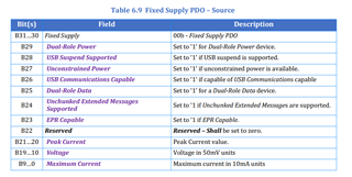

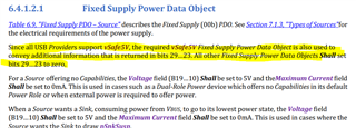

We are considering a configuration for the TPS25751 that does not use an external EEPROM, and we understand that various registers will be set using 4CC commands from an external EC.
We confirmed for the TPS25751 TRM, and we would like to know about the PDO settings.
As an example, for the source PDO settings, I think that we would lile to set "TX Source PDO x" in Table 3-17 of TRM, but I don't know how to determine the value of this register.
Among them, the initial value of Tx Source PDO1 is "260C844Ch", which I think means 5V, but if I don't understand this setting value, I won't be able to set the other PDOx, so could you please tell us?
