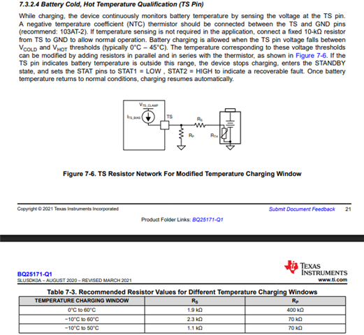

Could you provide -20°C to 60°C RS and RP resistance recommendation?
Hi Fabio
Recommend Rs=2.3k and Rp=42k for -20C to 60C
