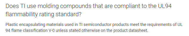

    As a work around for this problem, I am planning on implementing the comparator for Temperature myself for both the batteries externally and use Digital logoc to pull CE pin high if the temperature limits are exceeded on any of the batteries in parallel. Would this work for UL94V certification or has the feature be implemented on the chip itself?
    The packaging for most TI parts is UL94 V-0 compliant.
    https://www.ti.com/support-quality/certifications-and-standards/certifications-home.html
    Alec
