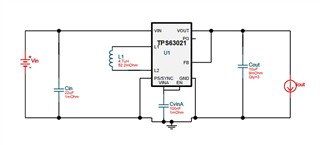

  • Hi Tao,
    Thanks about the peak voltage.
    I am looking for a way to reduce the current consumption of the TPS63021 in power save mode as much as possible. For example, is it safe to use an inductor coil of 4.7 μH? I was looking at Webench Power Designer and found a circuit using a coil of 4.7 μH.
    If there are other measures to reduce the current consumption, could you please let me know?
  • Hi  Kimba,
    4.7uH should not be a good option if you have PWM mode over your actual load. Because it will  obviously reduce frequency of RHPZ and may cause unexpected instable loop.
    From other side, change inductor to 4.7uH may not work to improve efficiency over your load. Especially when you load is ultra light, then quiescent is main part of consumption.
    If possible, i think swap to our new BUBO device should be a goog idea, such as TPS63900,TPS631000, TPS631010/1. Their quiescent current is much lower.
    Tao
  • Thanks Tao,
    Our highest IOUT is 10mA so we would not be using PWM mode. If so, would it not be much of a problem?
    The converter itself is consuming between 25 to 50 μA due to switching and I would like to stabilize this as much as possible.
    It's difficult to choose a different IC in this case.
  • Hi Kimba,
    Got it, since maximum load is 10mA, then i think you are free to change the inductor if you want.
    Tao
