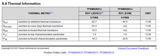

Hi support team,
I think the SW pin should be "unconnected" to reduce EMI, and "be soldered to a small pad" to dissipate heat.

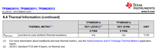

Is the SW pin "unconnected" in the "Thermal Information" measurement conditions?
I visually inspected the TPSM828512EVM, but I cannot determine whether it is "unconnected."
Ultimately, I would like to know the recommended method for handling the SW pin.
