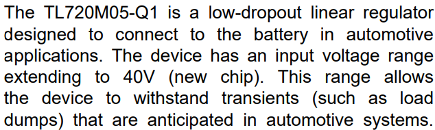

1. What is the reason to have new chip? Original 45V could sustain 40V and why we need down to 40V?
    The motivation behind creating a new chip for TL720M05-Q1 is for supply continuity. The fab that runs legacy TL720M05-Q1 material is closing, and by transitioning this device to a new chip, it allows the customer continuity (instead of EOLing the device, for example).
    There is a difference in the Vin rating for legacy vs new chip variants of this device, as you note. However, this is not expected to impact the vast majority of use cases for this LDO, since 12V-battery-connected LDOs typically require a Vin rating of only 36V to handle load dump conditions. Please let me know if your customer is experiencing a problem with the 40V Vin rating, though.
