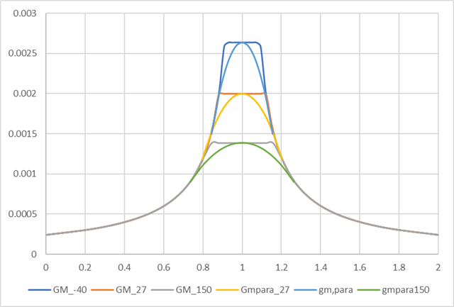

  • Hi Teritama,
    Thanks for your interest in the topic.
    Regarding the Source current for the COMP pin, the information provided by the designer is explained below.
    According to the attached waveform of gm versus FB-VREF, you can see, gm is not constant, but parabolic and reaches a maximum value for VREF = FB. In the implementation of LM5156, there is also a temperature dependency. This is not the case in every device.
    Always, gm is limited by the maximum current the circuit can provide, which here is 240 uA +/- 25%.
    For a small delta between VFB and VREF, gm is proportional to (VFB - VREF)**2. Is due to the characteristics of the MOSFET (ID~(VGS-VTH)**2).
    When VFB-VREF becomes larger, the current is limited by the bias applied to the circuit. That curve you can also find attached.
    Hassan
  • Hi Hassan,
    Thank you share the designer's explanation.
    I understood that when small delta between Vfb and Vref, Gm is gm is proportional to (VFB - VREF)**2 from MOSFET characteristic and when vfb=0V, the source current is limited typ 240uA +/- 25%.
    In the second curve, It seems X-axis is Vfb-Vref, Y-axis is the source current from internal transconductans Amp output(Io). Is my understanding correct?
    And the limited current value(240uA +/-25%) is from bias operating current? I guess the difference of value is from BIAS supply to other block tin same time.
    teritama
  • Hi Teritama,
    In the second curve, the X-axis is Vfb, Y-axis is the source current from internal OTA.
    Yes, the limited current value (240uA +/-25%) is from bias operating current.
    Hassan
