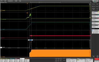

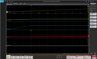

I'm using the UCC28C43 as the flyback controller (DCM operation). I have designed a startup circuit to supply the controller intially. This will supply until the flyback output is ready to takeover the controller consumption. At slow ramp up of flyback input voltage, the Startup Circuit (SUC) will supply the energy and increases the Vdd of the controller. When Vdd reaches the ON threshold the controller draws some energy from the Vdd capacitors to generate Vref and after some time the PWM. The PWM duty will gradually increase to its full value when the soft start time is completed. Now my question is related to the energy required by the controller during this soft start phase of the controller.
In my application, the soft start time is chosen as 180ms (replaced 1uF CSS cap with 10uF for these measurements). When the input voltage of flyback ramp up is faster (80V/s), the energy coming into the Vdd capacitors is sufficient to deliver the controller requirement. Hence the PWM are generated and the flyback can take over the consumption of controller and bypassing the SUC.
But when the flyback input voltage ramp up is slower (10V/s), there are no PWM generated. Beacuse some events are happening in the controller which need energy from the Vdd capacitors and this drops the Vdd below the Turn OFF threshold of the controller and turns OFF the controller. This is kind of a hiccup mode and continous as shown in the below image.

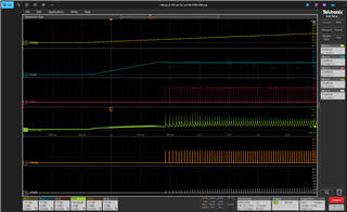

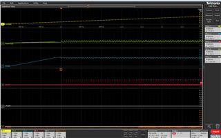

    For topic 3, if the soft start doesn't change the IC consumption. Then could you please help me understand the following behaviour.
    At minimum load (say 1W) on flyback output and 18ms soft start setting, the controller is able to generate PWM. In this case the input current from start up is less so the hiccup mode. When Vdd above ON threshold, the PWM is generated. But the controller energy requirement discharges the Vdd and controller turns OFF when Vdd goes below OFF threshold.
    At very light load (say few tens of mW) on flyback output and 180ms soft start setting, the controller is not able to generate PWM at all. Why is this happening?
    Thanks in advance!!
    Have a nice evening!!
    Chaitanya K
    Longer soft start time requires more energy from VDD capacitors before switching (i.e. before COMP reaches > 1V). So longer soft start time has longer time to make COMP > 1V, but during this time, still consume energy to make VDD capacitance voltage lower, the current still the same up to 3mA. That is why.
