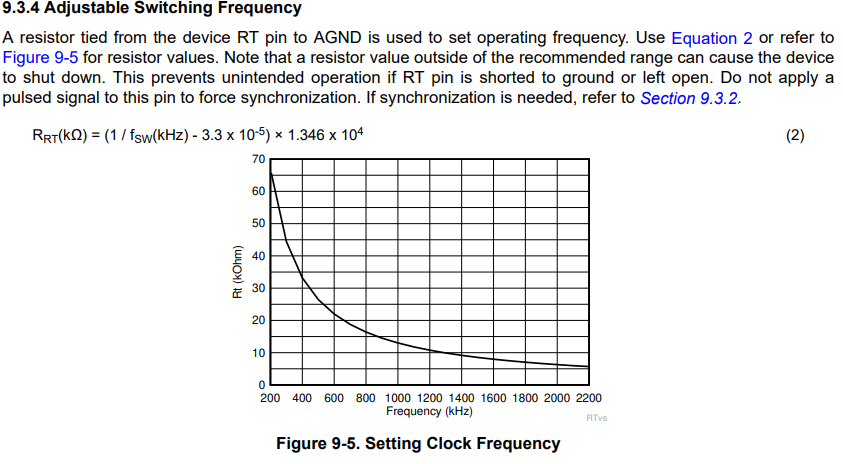

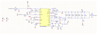

In our design we are using LM61460AASQRJRRQ1 part.
I want to know about the calculation for the Pin 6 : RT.
How the value of 32.4K is selected ?
Please help me on the above query !

Hi Tirthal,
Please see section 9.3.4 in the datasheet:
