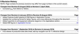

When I checked the latest datasheet, I did not find any change log that mentions the thermal pad change:
In Revision A the pad size was specified as 2.4 x 3.1 mm.
In Rev. C on page 33 the pad is specified as 2.7 x 3.4 mm max, whereas on page 37 it is specified as 2.4 x 3.1 mm max.
Which is the correct dimension? And why was the change in pad size, land pattern, stencil design, etc. not indicated in the revision history or PCN?
