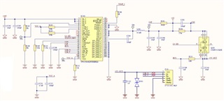

Hi Team,
Does this IC automatically manage the handshaking with DP_IN & DM_IN pins or i need to use any other controller along with this? I didn't connect any resistors on these lines and DP_OUT & DM_OUT are left open. and CTRL1 & CTRL2 are pulled high to select CDP mode.
I don't need any communication on data lines.
Only some mobiles are charging and some mobiles and tabs are not charging. By shorting D+ & D- on USB port, all mobiles and tabs are charging.
What is the fix to make it as universal charger with current limit up to 2A apart from shorting D+ & D-. I set overload trip threshold at 2.5A and it's working good.
