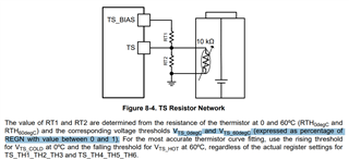

    Also, it seems like the REGN voltage fluctuate. It looks like the targeted Vout for REGN is 5V, but it will still operate under when the source is 5V with LDO Vdrop.
    When Thermistor is connected as below, shouldn't you also be considering the REGN voltage to accurately monitor the voltage? Is there a relationship beween voltage source (USB VBUS or 1S VBAT) vs REGN?
    The above question is important as the usecase here is targeted under 5V, the USB VBUS is non-PD and the 1S is around 3.3~4.2V.
    Luke
    To clarify, TS_BIAS has an internal connection to REGN so they will be the same voltage. Since the voltage thresholds are expressed relative to REGN (or TS_BIAS), there should be no impact on behavior due to the voltage source or the voltage on REGN.
    The voltage thresholds are relative to REGN, they are based expected resistance ratios at different temperatures. So even though REGN may be higher when VBUS is present and lower when only a 1S VBAT is present, the device should be able to identify the correct temperature.
