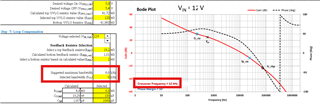

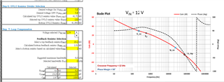

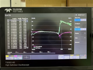

Hi Hassan
I have a problem
When I measured the Bode plot on the oscilloscope, it matched my calculations perfectly.
I would like to ask if there is a problem with my design?
Calculate the results using Excel

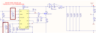

Hi Paul,
Thanks for reaching out again.
Can you please share your schematic and excel calculator?
Hassan
Hi Paul,
Can you please attach the complete schematic for the converter, and kindly, mention the input/output specifications of the converter?
Hassan
