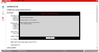

I am currently evaluating the LP5569EVM using the official LP5569EVM GUI software.
The installation and hardware connection of the GUI program were completed successfully.

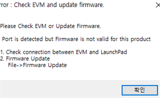

However, I am experiencing repeated issues when using the GUI with the MSP-EXP432E401Y LaunchPad connected to the LP5569EVM board. The following error messages appear upon launching the GUI:
- "Please update firmware"
- "Firmware is not valid for this product"

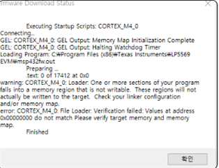

2. Flashed a custom `.txt` firmware to the MSP432 using DSLite
3. Attempted to flash the `msp432fw.out` file included in the GUI installation folder

Despite these efforts, the GUI continues to display an invalid firmware error.
