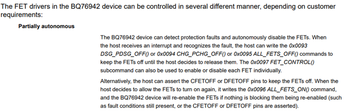

We've the following situation
  1. We sent the ALL_FETS_OFF command on startup.
  2. Reading FETStatus tells us that CHG_FET and DSG_FET are low (0).
  3. We force a fault condition to occur. E.g. disconnecting a temperature sensor.
  4. Through an external input, we sent the ALL_FETS_ON command.
  5. As expected FETStatus still shows that the FETs are turned off.
  6. How do we know if we should resend again with our external input to allow autonomous FET handling again?
Is it possible to read the FET driver mode? So we can know that the FETs will be turned on when the fault condition resolves itself.
After reading through the Technical Reference Manual for BQ76972 and checking bqStudio, we couldn't find anything that answers that question.
We've looked at Settings:FET:FET Options[SFET] in case that would change, but it didn't.
Any help is appreciated!

    We're curious about the state in which the FET drivers are. Especially after sending the subcommand ALL_FETS_ON.
    The technical reference manual mentions the following:
    Is there a register we could read to see if a FET is manually turned off by the host for example? Or if it is driven autonomously by the BQ device.

    We don't have a register to indicate FET was turned off by BQ or by Host. You can only determine if you want BQ to control FETs autonomously. And you can read 0x7F FET Status() and Safety Status A/B/C to see which protection trigger the FET turn-off.
