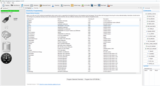

  • Hi Alan,
    Ok, I understand. So, how could I found and use the tool GPCCHEM. Here is a screenshot of Bqstudio when I choose this gauge :
    I do not have access to the GPCPackager with this ref of gauge. How can I proceed?
    Thank a lot

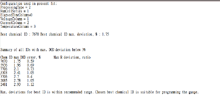

  • Hello Andrianina,
    Follow the GPCCHEM report instruction and submit the necessary files it requested. This is not a tool internal to BQStuido rather it is a tool outside of the software. Once you do submit your required files you will get a file similar to the image below and than you would use the chemID with the lowest "deviation, %". Once you get your chemID you would then go into BQStudio>>Chemsitry>>ChemID>>Program selected chemistry.
    GPCCHEM:
    https://www.ti.com/tool/GPCCHEM
    Thank you,
    Alan
    *Only an example DO NOT USE ON YOUR APPLICATION
