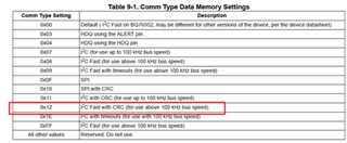

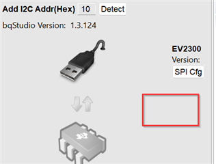

I am trying to enable PEC for I2C communication on the BQ76952 using BQStudio. I followed the steps outlined in the EVM user guide:
  1. Set Comm Type to 0x12 (I2C with PEC) in BQStudio. (Refer to Figure 2)
  2. Send the SWAP_COM_MODE command.
  3. Restart BQStudio.
  4. Read Cell 1 Voltage (Command 0x14) to check communication.
However, I2C communication still does not include PEC, as shown in I2C waveform.
Did I miss any steps? How can I ensure that PEC is enabled in BQStudio for BQ76952?
