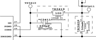

Hi team,
Can you please help review my customer Valeo LP8864S design as below? Thanks

Hi, Xiaowei
Pls see my feedback in below;
Hi Zhiqian,
About Valeo application:
1. LED strings : 4 strings, 14 LEDs in series. LED voltage range :2.8-3.3V (The LED datasheet is attached). And I want to confirm whether the max output voltage of 48V they set meets the design?
2.If they change the P-MOS to a diode, will the chip boot and work properly?
Xiaowei Zhang
Hi, Xiaowei
We recommend 2-3V for maximum operation, 48V is not enough for 3.3*14+1=47.2V requirement.
Yes, it can work normally.
