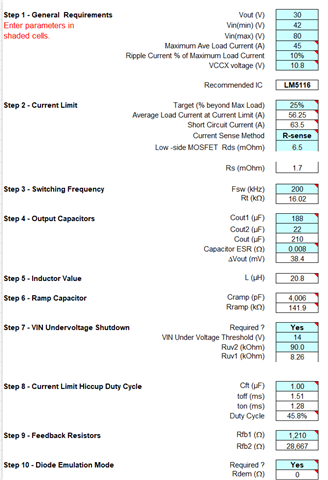

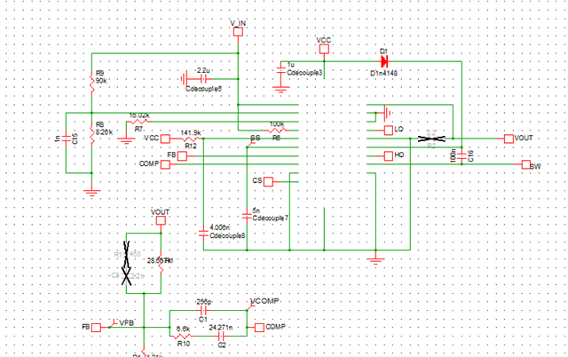

I created a model of LM5116 for SIMetrix software and did the schematic for transient analysis but the model is not working properly.
the problem in the simulation is that HO is always high and LO is always low, means that high side switched from beginning is ON and nothing is switching in the simulation!
I followed datasheet recommendations and quick start sheet to set the parameters.
Can you please support me to debug the problem and why it is not working!
The simulation schematic and LM5116 library model are attached!BUCK_LM5116_draft.zip
