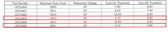

    The typical threshold ON/OFF is specified as 4.1V/3.6V respectively.  Are these values read at the REF pin (pin-8?)

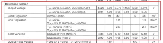

    On the REF, the datasheet specifies:
    Since OUT mentioned in your previous message, if it is what you need to know, OUT  is related to CS and COMP.
    Please let me know which above is what you want to know. If none of them, please indicate which page and which paragraph you would like to knwo the test set up. Where is 4.1V/3.6V found in the datasheet?

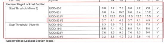

  • I think you are referring the below. If so, the 3.6V and 4.1V are typical VCC UVLO on and off thresholds.
    VCC has MIN and MAX as well. Our test setup is to check OUT of a device under test to make sure it is in swtiching operation with VCC at MIN and at MAX. Its Typical value is usually an averaged value from the test results.
    Hope this answered your question. Otherwise, we will make further discussion.
  • To make it further clear, we do the test to make sure OUT switching with VCC in between MIN and MAX of its ON threshold. We also do the test to make sure OUT not switching with VCC in between MIN and MAX of its OFF threshold.
