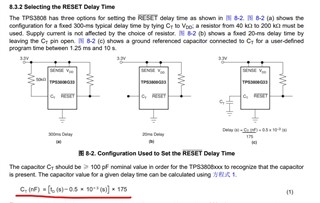

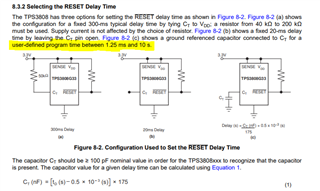

Hi Team,
Using TPS3808G30DBVR,
CT configuration capacitor 10uF, calculated according to the formula for about 57 seconds, but the actual test is 47 seconds. What is the reason?
Hi Reed,
A ground referenced capacitor connected to CT for a user-defined program time between 1.25 ms and 10 s.
