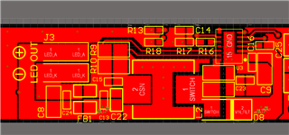

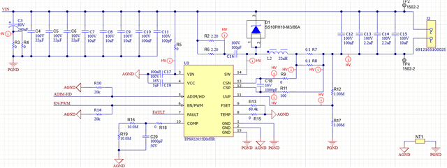

Hi all,
We have developed a electronic pcb with the TPS922052. We have tested TPS922052 and TPS922053 but we have problems with the radiated emitions.
Our buck have to convert 48V to 42V output with 600mA output current.
You can see the schematic with the snubber filter in te following image.
On the other hand, you can see our pcb layout in the following image.

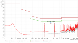

You can see the results we have for conducted in the following image:

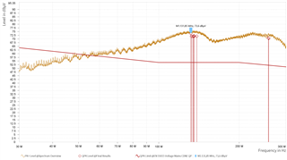

You can see the results we have for radiated in the following image:
Could someone help me? I think the buck layout is good. Is the snubber network correctly placed in the schematic?
