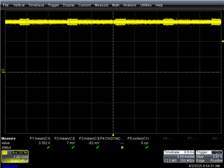

    Waveforms of signals where all four TPS274C65 chips are powered:
    MISO signal of a SPI data transfer. The high level of the signal reaches +3.3V.
    MOSI signal of a SPI data transfer. The high level of the signal reaches +3.3V.
    VDD signal of a TPS274C65 chip with the internal voltage regulator. The voltage level of the signal is +3.3V.

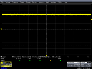

    VS signal of a TPS274C65 chip with the internal voltage regulator. The voltage level of the signal is +24V.

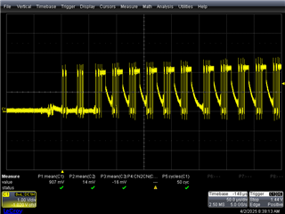

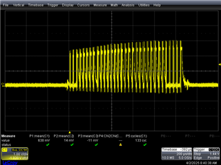

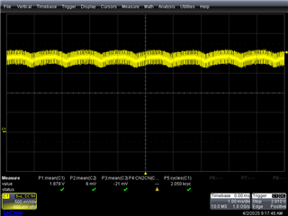

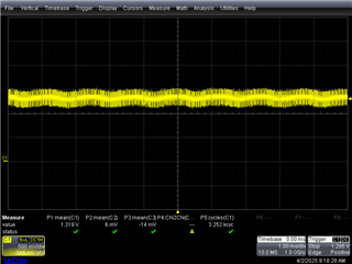

    Waveforms of signals where the two TPS274C65 chips with the internal voltage regulator are disabled:

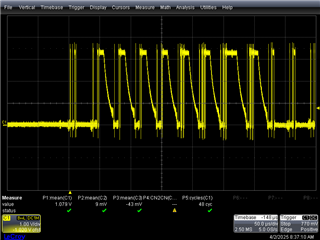

    MISO signal of a SPI data transfer. The high level of the signal only reaches +2V at the beginning of the transfer.
    MISO signal of a SPI data transfer. A data packet sequence is transmitted. The high level of the signal is initially at approximately +2V and increases up to +2.5V towards the end.
    MOSI signal of a SPI data transfer. The high level of the signal reaches +3.3 V and isn't affected by the two unpowered TPS274C65 chips.

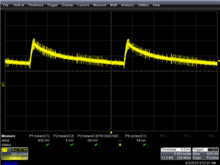

    VDD signal of a TPS274C65 chip with the internal voltage regulator. A SPI data packet sequence is transmitted every 10 ms, where every second sequence contains a larger data packet. This transmission interval of the larger data packet corresponds to the frequency of this capacitive charge and discharge signal (~20ms). The peak voltage level is approximately +1.5V.
    VS signal of a TPS274C65 chip with the internal voltage regulator. A SPI data packet sequence is transmitted every 10 ms, where every second sequence contains a larger data packet. The peak voltage level is approximately +1V.

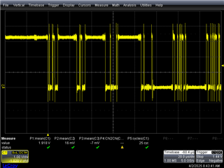

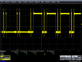

    VDD signal of a TPS274C65 chip with the internal voltage regulator. A SPI data packet sequence is transmitted continuously. The peak voltage level is approximately +2V.
    VS signal of a TPS274C65 chip with the internal voltage regulator. A SPI data packet sequence is transmitted continuouslyThe peak voltage level is approximately +1.5V.
