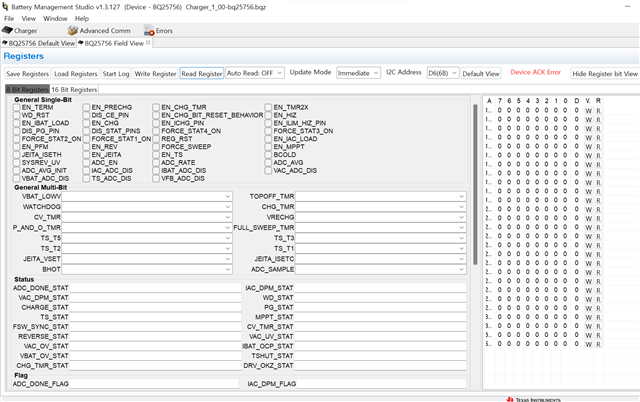

    when I test using BQ25756 EVM, I can not read I2C data. If I miss setting point, please let me know.
    What's your test setup here? Are you using the EV2400 with BQStudio or the USB2ANY with TI Charger GUI?

    - EV2400 communication kit, I2C to USB
    when I test using BQ25756 EVM, I can not read I2C data. (Device ack error)
    But, When I connect battery only, I can read I2C data using EV2400 tool.
    I want to know the BQ25756 is possible to operate with VAC source except battery.

  • Hello Ben,
    Thanks for the new information.
    It should be possible to use I2C when only VAC is applied. When you only have VAC attached to the IC, can you measure the voltage on the VAC test point on the EVM?

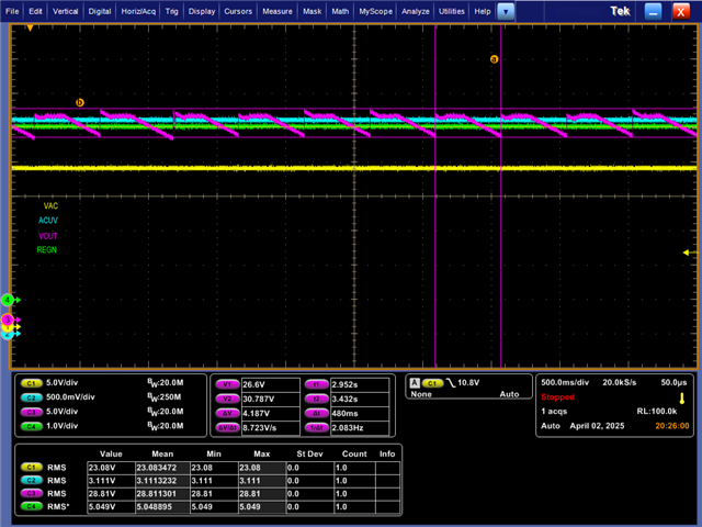

  • Hello Ethan
    It works well, but I set the same condition than before..
    I think the output voltage swing means it repeatedly charges and discharges using an output capacitor.
    In this output voltage condition, can I set increasing the e-load? (Target : ~100Wmax)
