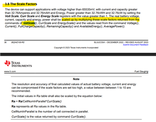

We are making use of the BQ34Z100-R2 , lead acid battery 12v,7Ah. I am not able to modify the Design Voltage 3000mV to 12000mV. How to modify?
Hello Ankit,
The max limit for design voltage is 5000mV, however what you would need to do is use the Voltscale(). Essentially what this means is that you would divided your real design voltage by your VoltScale and as well as dividing any other parameter that uses voltage in its measurements.
