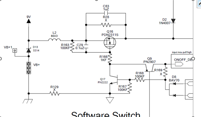

TPS22917: use the TPS22917 to replace the discrete circuit
Part Number: TPS22917
Other Parts Discussed in Thread: TPS22810
hi Sir
may I use the TPS22917 to replace the discrete circuit,Thanks
  • Hello Chen,
    Thanks for reaching to E2E.
    Yes, You can replace the discrete solution with load switch or eFuse with integrated FET.
    This is a 9V voltage rail. TPS22917 is 5.5V device.
    You can check TPS22810 which is 18V and 2A application.
