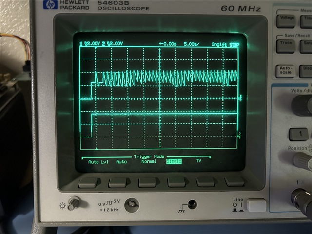

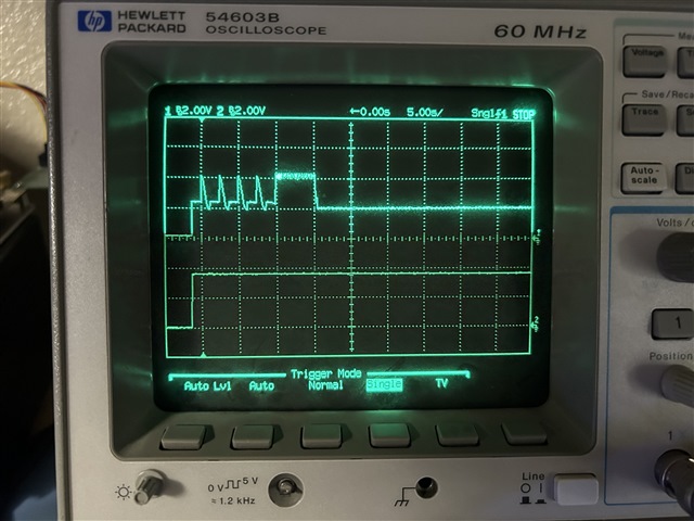

Hi there—our design comprises the BQ25798 with a 1S4P battery pack that uses the BQ40Z50 for primary protection. The programmable shutdown threshold of the BQ40Z50 is set to 2.6 V in our application, and the BQ40Z50 has a non-programmable shutdown threshold of approximately 2.2 V.
I have replaced the cells in the battery pack with a Keithley 2308 cell simulator to test the interaction between the BQ25798 and our battery pack's protection board during various conditions. The regulated output of the Keithley 2308 is referred to as VCELL in the notes below.
I find that if VBUS is applied while VCELL = 2.5 V (less than the programmable shutdown threshold of the gas gauge), the BQ25798 rapidly enables and disables VBAT as in channel 1 (top) of the capture below. VSYS is stable as in channel 2 (bottom) of the same capture.
The cell simulator shows no current actually flows into the cell; therefore, the battery pack does not charge during this condition. Since VBAT (i.e. the pack voltage from the perspective of the gas gauge) is repeatedly applied and removed, the gas gauge never wakes up.
Conversely if VBUS is applied while VCELL = 2.7 V (greater than the programmable shutdown threshold of the gas gauge), the condition settles very quickly; VBAT remains enabled and is pulled down to VCELL, and the cell simulator shows that the desired precharge current flows into the cell:
Based on the registers read from BQ25798, it seems it is repeatedly cycling among trickle charge, termination complete, and taper charge:

Also of note is that while the BQ25798 operates in trickle charge, VBAT_PRESENT = 0 and VSYS_STAT = 1 (VSYSMIN regulation). During charge termination and taper charge, VBAT_PRESENT = 1 and VSYS_STAT = 0; this is confusing, as VSYS is clearly in VSYSMIN regulation throughout the entire sequence of events.

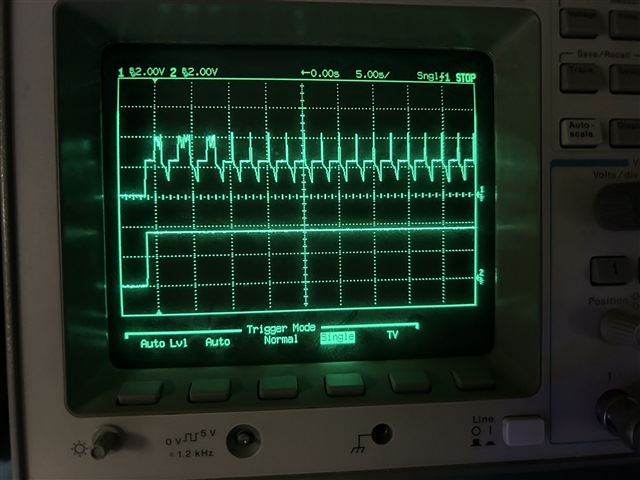

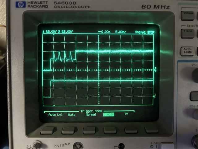

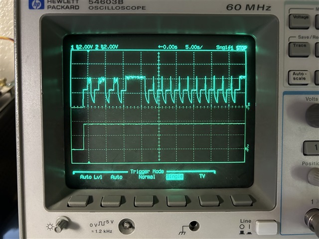

On a hunch, I lowered TRECHG from the default (1024 ms) to the minimum (64 ms) so that VBAT cannot collapse significantly. Now, VBAT remains enabled even for VCELL = 2.3 V (greater than the non-programmable shutdown threshold of the gas gauge):
The couple of brief oscillations occur because our system firmware cannot lower TRECHG until a few seconds after the system boots, and TRECHG remains the default (1024 ms) for a brief time. The 5-second period that follows appears to correspond to the non-recoverable undervoltage protection delay in our gas gauge, during which it waits to enable the CHG FET.
What I suspect to be happening here is that after the gas gauge wakes up, it disables zero-volt charging and opens its CHG FET for 5 seconds; charging current falls below the termination current, and the BQ25798 immediately jumps to the termination state from any other charging state.
We have seen similar behavior when the CHG FET opens due to some other reason triggered by the gas gauge (e.g. overtemperature)—the BQ25798 briefly believes charging is complete, before it attempts to restart charging, and VBAT OVP is triggered as a result of the CHG FET remaining open. Please consider the following questions:
[1] Are these results expected—including the "jump" from a relatively early charging state (e.g. trickle) to termination, as well as the various values returned for VBAT_PRESENT and VSYS_STAT?
[2] Is there any risk in lowering TRECHG as I have done, or would any other workaround be more preferable?

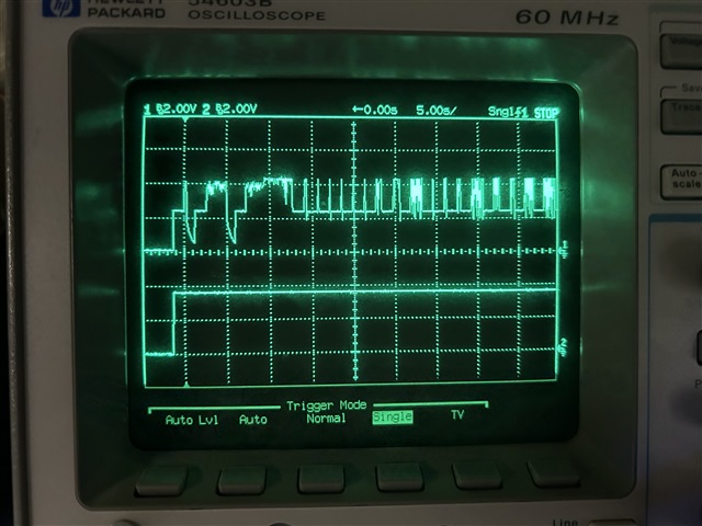

With this workaround in place, I noted another behavior for VCELL = 2.1 V (less than the non-programmable shutdown threshold of the gas gauge):
Here, it seems that VBAT remains enabled, but consistently cycles among VREG, VCELL and 2.5 V (the trickle charge regulation voltage). Once more, the cell simulator shows no current actually flows into the cell. I suspect that in this case, the zero-volt charging current of the gas gauge is less than the termination current, and the BQ25798 repeatedly stops and re-starts charging for the same reason.
[3] Is this last result expected? We ultimately wish to implement secondary non-recoverable undervoltage protection in the range of 2.0–2.2 V; therefore, it's actually preferred that the battery cannot be recharged below VCELL = 2.3 V anyway. However, I'd like to understand the mechanism here, and whether or not it can be predictable across operating conditions.

  • Hi Jeff,
    SYSMINSTAT=1 whenever V(SYS) > V(BAT) and the minimum system regulation loop is active.  VBAT_PRESENT=1 does not come on until the charger is out of trickle charge. There are deglitch times for the all of events you are seeing that delay VBAT_PRESET being set so I don't recommend relying on that bit.
    The results above are expected, unfortunately.  With no battery or protector FET open, the charger starts in trickle, then pre then fast then OVP then charge stops and repeat. The timing of the pulsing is a function of the capacitance on BAT, recharge threshold, recharge timing and auto discharge at OVP registers.  There is current flowing in short pulses so eventually the pack would charge.
    The simplest but costliest fix to prevent the OVP and pulsing is to add 200uF (slightly less if charge current is set low) to BAT pin.  The other "workarounds" (like changing VRCH timing or threshold) do not prevent the pulsing but change the frequency.  I am surprised that you found a setting that quickly prevents the pulsing.
    Jeff
  • Hi Jeff—thank you for your prompt reply. We currently have about ~30 uF on VBAT; perhaps that's why we were able to work around this problem by lowering TRECHG alone.
    Our next revision happens to be in layout, but the height is very constrained in this area; I will see whether we can manage one 6.3-V 220-uF tantalum here. A couple questions about that solution:
    [4] Is the idea that VBAT would be driven to OVP one time, then the bulk cap would sustain VBAT until the protector FET closes after the gas gauge's 5-second startup time?

    In the meantime—for the last case with TRECHG = 64 ms and VCELL = 2.1 V, the gas gauge is shut down entirely; the protector FET is not open per se, but presumably operates in the ohmic region on behalf of the zero-volt charging function of the gas gauge.
    It looks like VBAT holds steady at 2.5 V for 1–2 seconds, then hits OVP; I presume this corresponds to the point at which the charger moved from constant-voltage trickle charge to constant-current precharge, at which point the ohmic protector FET looks like an open circuit.
    [6] Is this 1–2 second delay the internal deglitch time you mention?

  • Hi Jeff,
    Regarding 4, the big cap prevents OVP.  So charge repeatedly terminates and recharges, creating a much smaller oscillation on BAT pin.
    Regarding 5, the 200uF is based on my empirical testing.  I don't have a closed form equation.  Some settings, like IINDPM or ICHG<0.5A or certain VBUS to VBAT combinations, allow for slightly lower capacitance (like 100uF).  200uF seem to address all VBUS to VBAT configurations at the default ICHG=1A.
    If VBAT < 2.5V, the charger regulations BAT to 2.5V with only 100mA trickle current for 1.5s before transitioning to precharge then fast charge.

  • Hi Jeff—thank you for your comprehensive feedback; I apologize for my delayed response. I am happy to report that this problem is solved by adding a large bulk capacitance to VBAT according to your suggestion, and adjusting the registers described in this thread.

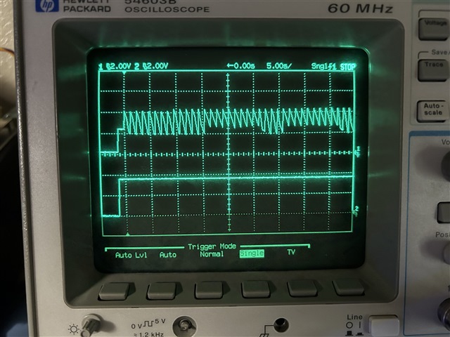

    First, I returned TRECHG to its default value (1024 ms) and confirmed that the original problem can be reproduced with VCELL = 2.1 V and no additional bulk capacitance on VBAT. In all of the captures that follow, VBAT and VSYS are shown on channels 1 (top) and 2 (bottom), respectively.
    Next, I added 220 uF to VBAT and confirmed that the oscillation is much less pronounced, presumably because the charger reaches termination before OVP and hence restarts much more quickly.
    The maximum period of the sawtooth is equal to the 1.5-second delay to precharge, plus TRECHG. Often, the period is smaller as the charger appears to go straight to precharge as soon as the gas gauge briefly wakes up.

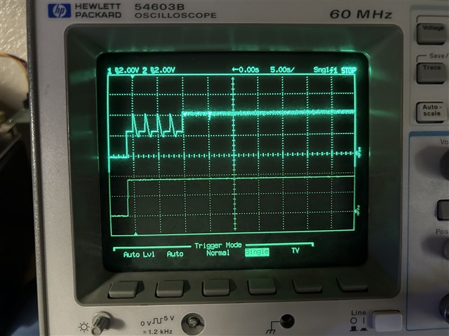

    Next, I reduced TRECHG to its minimum value (64 ms) again. Our system firmware takes several seconds to start, so the sawtooth is not immediately relieved. Once the register is written, however, we see VBAT hold much more steady as charging repeatedly restarts almost instantly.
    Notice there is still a problem here, as VBAT stays near VREG and is not loaded down by VCELL, indicating the protector FET is still open. The current readout of the cell simulator confirms the pack is not charging.

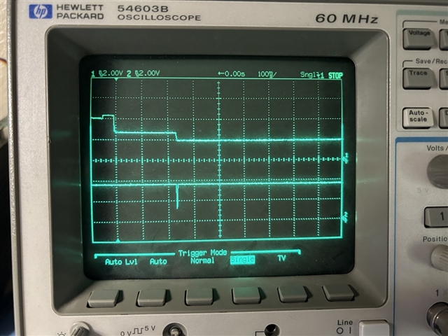

    Reading the gas gauge registers confirms it is not in any fault state; rather, it operates in zero-volt charging mode for VCELL < 2.2 V. In this case, the protector FET operates in the ohmic region, and is not fully enabled; this is expected behavior for BQ40Z50.

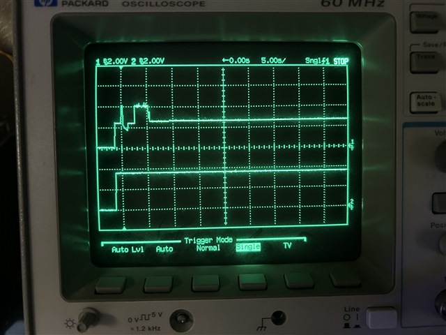

    I lowered the zero-volt charging threshold of the gas gauge to 1.8 V. Now, we can see the protector FET is open for only 5 seconds; this corresponds to the blanking period during which the gas gauge waits to enable the protector FET.
    Afterward, the protector FET closes and VBAT is pulled down to VCELL. Finally, the current readout of the cell simulator confirms the pack is charging steadily.
    Last but not least, I repeated this experiment with VCELL = 1.9 V. In this case, the protector FET stays open after the 5-second blanking period. This is by design, and corresponds to the non-recoverable undervoltage protection we've enabled in the gas gauge for VCELL < 2.0 V.
    We've added a 220-uF bulk capacitor to VBAT in our next PCB revision. In the meantime, I just wanted to confirm the following with you:

  • Hi Jeff,
    Great news and documentation!  I will use this thread for other customers having issues with BQ40Z.
    Regarding 7, the TRECHG is a time hysteresis.  If the battery's impedance is high, it's cell will relax after termination, resulting in the charger going in and out of recharge more quickly.  Otherwise, I don't see an issue.  You can work around that using the top off timer, i.e. delay termination to give time for the battery to relax.
    Regarding  8, there is no need to disable the pull down since undesired OVP no longer occurs.
