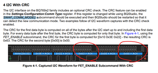

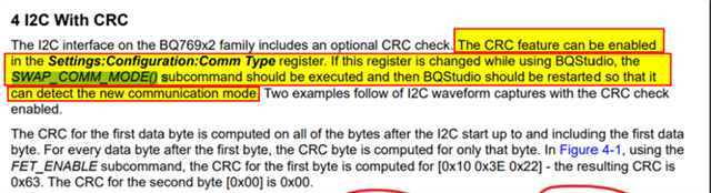

  • Hi Alexis
    I found SWAP_COMM_MODE() subcommand should be executed after exit config_update mode, is that must?
    And as guide example, I found 0x63 and 0x00 are CRC results, I'd like to know these CRC is sent by BQ76972 or by MCU?
    BR
    Amber
  • Hello Amber,
    If the I2C speed setting is changed while in CONFIG_UPDATE mode, the new speed setting should take effect upon exiting CONFIG_UPDATE mode.
    You would need to use the 0x29e7 SWAP_TO_I2C() subcommand to change the communications interface after changing the Settings:Configuration:Comm Type if you were not entering CONFIG_UPDATE mode to change it. Section 9.2 I2C Communications Subsystem from the technical reference manual explains this in more detail.
    The CRC results you circled are sent by the MCU. The MCU would send the command and after every data byte, there should be a resulting CRC byte.
