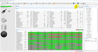

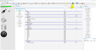

Hello Edi,
Below I've attached the picture of how to start and export a .log and how to export a .gg
*.log location
*Export .GG
Thank you,
Alan

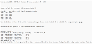

Hello Edi,
In order to best help you debug the situation can you attached a screen shot of your GPCCHEM report, just because the name on the chemID is the same of the one your are using doesn't necessarily mean that you have the right chemID.
GPCCHEM:
https://www.ti.com/tool/GPCCHEM
*This is an example of what I am looking for and don't use this for your application
Thank you,
Alan
