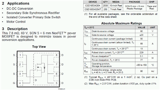

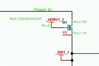

Hi this is my first time working with this MOFFSET.   I want to clarify looking a the schematic and the document I just want to make sure I understand.
I am using the the LM5176 part with 12V to 30V in and 12V out.
  • Hello Donald,
    Thanks for your interest in TI FETs. Yes, the CSD18534Q5A should work with the LM5176 buck-boost controller for this application. The small section of schematic looks correct. We normally recommend adding gate resistors for each FET to slow down FET switching in case the switch-node spike is excessive. These can be populated with 0 ohms if they are not needed. Please review the LM5176 datasheet and EVM user guide for more detailed design information. Let me know if you have any additional questions.
