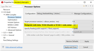

  • Hello BatMan,
    I wanted to follow up to clarify this issue for you and for anyone else on this forum.

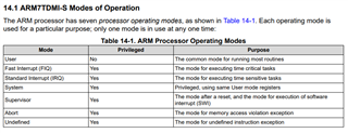

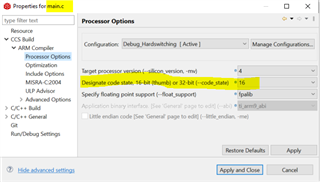

    The UCD3138A Arm7 core has two instruction sets: Arm Mode (32-bit) and Thumb Mode (16-bit). Section 14.4.2 page 476 in the UCD31xx Technical Reference Manual highlights the advantages of the Thumb instruction set, including higher performance and code density. Thus, Thumb Mode is the preferred mode for as much UCD3138A code as possible. For example, in the UCD3138128 Bidirectional DC/DC firmwaremain.c is set to Thumb Mode in the file properties.
    However, certain code must be configured in ARM mode, not Thumb Mode. Table 14-1 on page 472 shows a table between privileged (ARM mode) and non-priviliged (Thumb mode) code. For example, interrupts must be configured in ARM mode and not Thumb mode. If you check the standard_interrupt.c properties, then you can see that the file is set up for ARM mode.
    The line of code
    #pragma CODE_STATE(clear_program_flash_2, 32) // this will ensure that this code builds in ARM mode
     ensures that the following code will be built in ARM mode and not Thumb mode. Since the clear_program_flash_2() function comes from the clear_program_flash_2.c file, then your file may have incorrectly built the function in Thumb mode. Thus, adding the #pragma directive ensured the function was built properly.

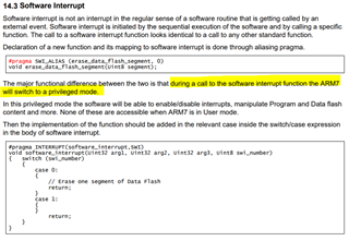

    The software interrupts are all in a single handler (Ex. 14 different cases) so that the UCD3138A will never be locked up in performing two different software interrupt routines at the same time. Since the software interrupts handle sensitive operations, such as accessing data flash, the routines must be handled one at a time within the software interrupt, and must be accessed in supervisor mode.
    More information about User Mode vs. Supervisor Mode can be found on section 14.3 and 16.1.10.
