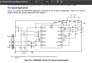

Hello Jason,
Hello Jason the 2p1s configuration will work with BQ28Z620, and below I've attached the datasheet for hardware, technical reference manual for software and EVM for the application.
Technical Reference Manual:
https://www.ti.com/lit/ug/sluuco9a/sluuco9a.pdf?ts=1743534595071&ref_url=https%253A%252F%252Fwww.ti.com%252Fproduct%252FBQ28Z620

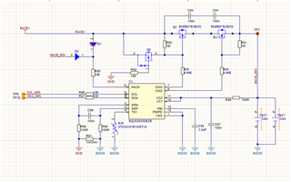

Dear Alan,
Please check if this principle is correct and what is the value of resistor R88 with 2P1S configuratio

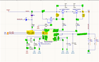

Hello Jason,
Your value for R88 works for your system and I had the marked up version of your schematic. Green is good and yellow just highlights the different values your schematic is and the evm.
