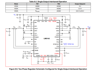

 I'm going to use LM5143 to generate single output (10Vin to 3.3V @ 30A). Is this buck controller can be use for single output? If yes, Can you share any reference.
  • Hi Roshan
    Yes, it can be used for single output. Check following configuration
    I would recommend you use LM5143DESIGN-CALC Calculation tool | TI.com for design calculations. It is a very useful tool. Additionally check this reference design - PMP23262 reference design | TI.com

     Thank you for your response & References. I'm planning to use LM5143 not as interleaved configuration. Only as single channel, single output. Is this buck controller can be use for single channel configuration? If yes, Can you share any reference.
    Thank you
    Roshan
  • Hi Roshan
    Yes, single channel configuration is possible. Disable ch2 by connecting EN2 to AGND. However, I would recommend using LM5141 for this use case.

  • Hi Onkar Bhakare,
     Thank you for your response. If i use the LM5143 as single channel configuration by connecting the CH2 enable pin to AGND. Can i let the unused pin as open?
    Thank you & Regards
    Roshan
  • Hi Roshan
    EN1/2 should never left open. I would recommend connecting it to AGND.
    Thank you
    Onkar Bhakare
  • Hi Onkar Bhakare,
     Thank you for your response. I designed & produced the module with single channel configuration and let the unused pin as open and EN2 is tied to AGND. The circuit was working fine. My configuration FB1-Buck VDDA. Switching frequency: 400Khz. Buck inductor: 1uH (IHLP6767GZER1R0M01). Current sense type: Inductor DCR (Rcs-7.5K, Ccs0.2uF), Output Cap: 1.8mF, Soft start raise time: 2.3ms
    But in startup, BUCK high FET was on for 10us. The IC working sequence was also as first top FET on after that bottom FET on. Also with out switching the bootstrap capacitor was charged to 3.5V (For Circuit reference refer the datasheet circuit). So when the first pulse of High FET on, the output voltage was developed to 2V. I'm enabling the converter at the input 9V. My buck converter output voltage was not match to soft start raise time. Can you clarify the switching sequence of the LM5143

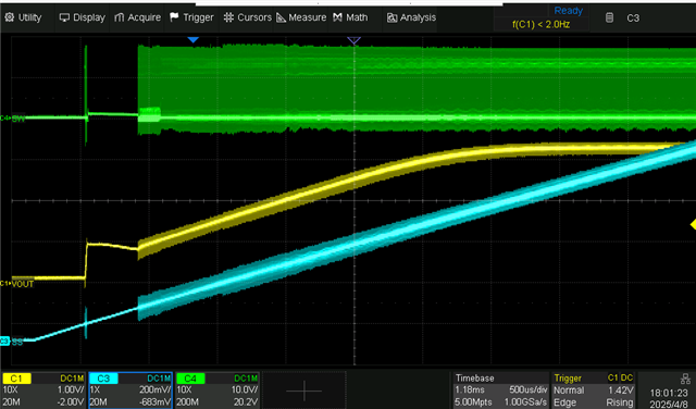

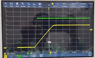

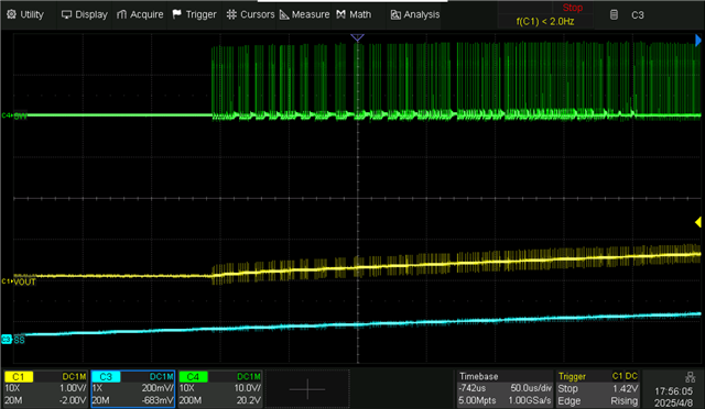

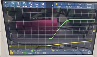

  • Hi Onkar Bhakare,
      Sorry for late reply, Refer the test wave forms. and provide your feedback
    CH1: +10Vin Sw
    CH2: Bot FET gate
    CH1: 3.3Vout
    CH2: +10Vin Sw
    CH1: 3.3Vout (Zoomed startup)
    CH2: +10Vin Sw (Zoomed First pulse)
    CH1: Soft start pin
    CH2: 3.3Vout
    CH1: Soft start pin (Zoomed startup)
    CH2: 3.3Vout (Zoomed startup)
  • Hello Roshan
    SS has inbuilt offset; device will follow SS once it crosses the internal threshold level.
    Waveform you shared has two parts
    1. SS below internal offset
    2. SS above internal offset
    At the start comp voltage goes ahead of its reference and device starts switching, however reference is still 0 V thus device stops switching and gradual fall in output volage can be seen, its minimal as device is operated under noload. Once SS crosses internal threshold, output starts following SS and total startup time is quite closer to what you have designed

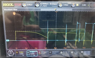

  • Hi Onkar Bhakare,
        Thank you for your response. In my understanding, The feedback reference will raise w.r.t soft start voltage. So if ss voltage is 0V. The FB reference will be 0V. So comp voltage also 0V. Also i have another doubt. My switching frequency is 400Khz. So my total time period is 2.5us. But the controller first pulse on time is nearly 12us. I don't know why the controller allow Ton time period beyond its fixed timed period. I tied DEMB pin to VDDA, So my converter operates in FPWM.
    Thanks & Regards
    Roshan
  • Hi Roshan
    - Yeah, that's correct, however it will be true after SS cross internal threshold voltage
    If you look at Zero-cross threshold during startup, it is similar to VDEMB = 0 V, PFM case. Zero crossing is part of the FPWM/PFM logic.
    Therefore, you are seeing PFM behavior during startup

  • Hi Roshan
    Kindly share your schematic for review
    Thank you
    Onkar Bhakare

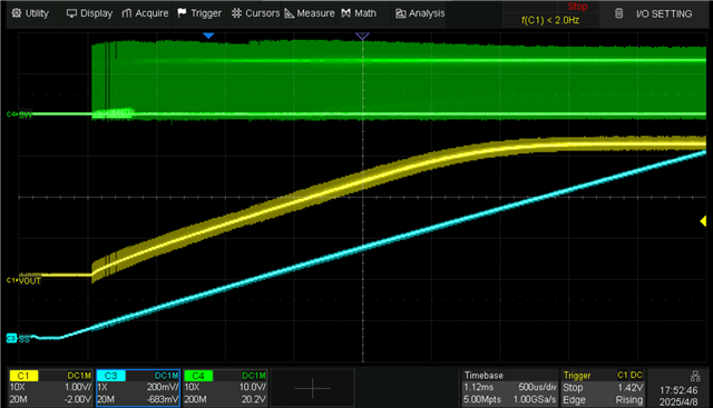

  • Hi Roshan
    I tested the single output configuration on EVM. I haven't noticed any big jump on output voltage
    Also, you can see PFM operation for few cycles during startup
    Could you please confirm status of MODE pin in your circuit
    I tried with MODE = VDDA (Single output interleaved operation), following waveform shows the behavior with this configuration
    MODE should be tied to AGND if you just want to use only single channel. Sorry I missed this in recommendation.
    Hope this answers your questions
    Thank you
    Onkar Bhakare
  • Hi Onkar Bhakare,
    Thank you for your response & solution, im my circuit i tied the MODE to VDDA. After connecting the MODE pin to AGND, smooth raise was observed at 3.3Vout. But if we connect MODE pin to VDDA, why the output raise not follow the ss raise.
    Thanks & Regards
    Roshan
  • Hi Roshan
    I have talked about it in my previous reply. Device won't take SS reference until SS crosses internal offset. Reference to device would be zero. Slight variation in Vout would cause COMP to go high and thus Vout will rise immediately. This is more prominent in multiphase setup (MODE = VDDA) due internal design. Comp will try to correct it however due to loop delay it increases to significant value. As load current is zero, output won't discharge much and will remain close to increased value.
