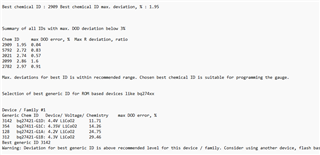

    Could you verified that you are using new cells that were at the same voltage/capacity when they were assembled and showcase your GPCCHEM calculator files that shows the difference % of the ChemID you are using.
    GPCCHEM:
    https://www.ti.com/tool/GPCCHEM

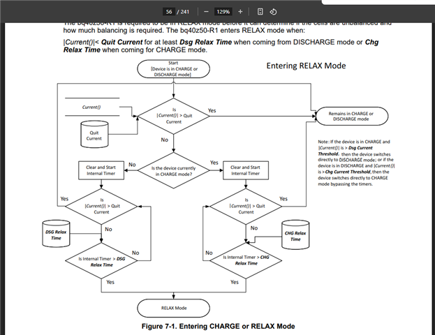

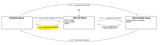

    After rereading the original comment it seeming that you have different aged cells if you are seeing a major difference in cell voltage espically as it reaches it termination voltage. With that being said the best method to verified your cells are indeed similar to each other either than the part number on them is using a different battery gauge that is 1s and putting them through the GPCCHEM calculator and verified that they each come up to the same ChemID with the same error difference %.
    However for charging you cells at low voltages I would recommend reviewing your Chg Current Threshold to verified the current you are pushing through the system is indeed closing the fets to allow for charging. But also review parameter such as your termination voltage, PF Shutdown Voltage, Shutdown voltage, and etc.

    After rereading the original question it is seeming that your issue is that you have one cell that is one the same as the rest due to various version such as aged, quality control and etc. I would still like to see the GPCCHEM calculator to verified your chemID.
    *This is an example of what I am looking for and don't use this for your application
