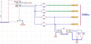

Hello Texas Instruments Team, can you please tell me if it is possible to protect SMBus lines using TPD4E1U06DBV?

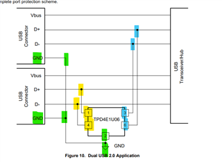

You can use this part for ESD protection however it does appear you have it connected wrong. If you follow the image below you can see why I believe that but I am not responsible for the TPD4E1U06DBV product and would reach out with another e2e to ask the question of application.

I connected it this way because I only need two channels from
this chip, I decided to just ground the unused ones.
And could you also clarify whether the ground should be
connected to PACK- or better yet to BAT-?
Hello Suslik,
The ground should be BAT- since it is always connected and as for the esd component it self you should ask another e2e for clarification.
