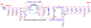

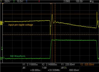

We test LMR14050SDDA input ripple voltage,there is a 33.33Mhz ring.
How can we resolve this 33.33Mhz oscillation?
Our waveform and schematic as below:

    1. Place small value cap (1nF) close to Vin pin and try to minimize its GND return path as much as possible.
    2. Increase value of R13 to slow down the SW node. I see its already quite high. Increasing further might impact efficiency.
    3. Increase the value of snubber cap
    Thank you

    1. Place small value cap (1nF) close to Vin pin and try to minimize its GND return path as much as possible.-----Why 1nf?
    3. Increase the value of snubber cap-----if  I increase the value of snubber cap,whether the snubber resistor will exceed its power limit?

    1. Small caps (1nF, 0.1uF) connected in schematics will have lower Series Resonant Frequency (SRF) thus will be able to suppress high frequency spike more effectively than higher value cap. It's a good practice to keep capacitor closer to IC in ascending order.
    2. Yes, with higher snubber cap you would need resistance with higher power rating

  • What is the cause of this 33.33M oscillation?
    Thank you
    yan
  • Hi Yan
    This result of ringing due to practice inductance of Vin - SW trace and internal bond wires with input capacitor. Thus, in order to damp this following step could be used as specified earlier
    Thank you
    Onkar Bhakare
