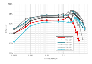

  • Hi  Lars,
    What should be the expected overhead of the TPS631010 when the load is 15 µA to 20 µA? Is the TPS631010 the Buck-Boost you recommend for this use case?
    Yes, since peak current is 800mA in your case, i think we do not have better option than TPS631010.
    According efficiency curve below, i think consumption you got is reasonable.
    Tao
