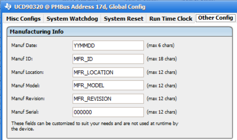

1.Is it possible to store card inventory data in the UCD device’s internal Non-Volatile memory (such as flash or other addressable registers) during the runtime, our intention is to use flash location in the UCD which can be used to store some card specific information, and can this memory be accessed or programmed by an external master via the PMBus interface?

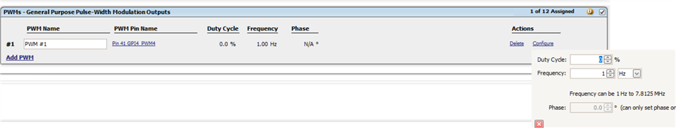

2.Is it possible to configure a General-Purpose Output (GPO/GPIO/PWM) to toggle at a specified frequency (e.g., for LED blinking),
  and if so, what is the frequency range that can be achieved we are looking for a low frequency range (1-10Hz)?
we are looking for this feature in this sequencing device. If not, possible what are the other sequencing devices will support these functionalities.

    1. the following are the only spaces that customers can access for own data
    2. For the UCD90320, the PWM can be configured between 1K -1MHz. If you need 1Hz-10Hz, you can try UCD90160A/UCD9090A.

    Is it possible to update manufacturing-related registers during runtime, and how can we ensure these updates are preserved even after a power cycle? Could you also outline a procedure for testing this functionality
    I tried setting the PWM frequency for the UCD90320 and UCD90160 devices, but the hardware configuration indicates the minimum frequency is 15.275 kHz. Is there a way to set a lower PWM frequency in the range of 1 Hz–10 Hz?
  • HI
    You can update the those settings runtime.
    If you want to make those change permanent(writing into the NVM), you have to write command 0x11 without any payload byte.
    Only PWM3/4 of UCD90160A can support 1Hz.
    Yihe

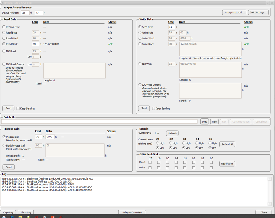

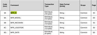

    I tried the following steps to write data into the UCD’s flash memory, but the updated value isn’t retained after a power cycle. The MFR_REVISION register is 12 bytes, and I can successfully write and read it during runtime; however, after a power cycle, the updated value reverts to the older configuration. Could you please review these steps and provide the correct procedure for permanently storing data in the NV flash?
    Steps:
    1. Write 0x9B with 0x123456789ABC
    2. Write 0x11 (Send Byte Only command)
    3. Read 0x9B → returns 0x123456789ABC
    4. Power cycle
    5. Read 0x9B → returns 0x3231 (original config), not the new value
    Thank you for your help,
    Sunil
  • HI
    Those are guaranteed cycle times.
    Please use GUI I2C debug tool to test and it works as expected.
    08:54:23.636: SAA #1: BlockWrite (Address 119d, Cmd 0x9B, 0x123456789ABC): ACK
    08:54:30.980: SAA #1: SendByte (Address 119d, Cmd 0x11): ACK
    08:54:45.385: SAA #1: BlockRead (Address 119d, Cmd 0x9B): ACK 0x123456789ABC
    power cycle the device
    08:54:51.766: SAA #1: BlockRead (Address 119d, Cmd 0x9B): ACK 0x123456789ABC
    Yihe
  • Hi Yihe,
    Thank you — it seems to be working with the SAA tool.

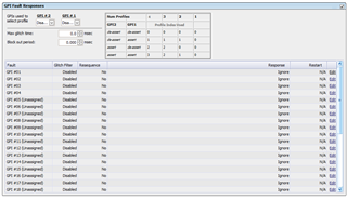

    2. GPI-Based Fault Shutdown on UCD90320
      I'm trying to implement rail shutdown and resequencing using an external GPI input. While the UCD90160 device offers a configurable option to fault shutdown rails based on a GPI trigger, I couldn’t locate a similar setting in the UCD90320 GUI.
      Could you please confirm if this feature exists for UCD90320, and if not, suggest an alternate implementation method?

  • Hi
    1. it is recommended to have a few seconds to have another I2C transaction after 0x11 command.
    2. if is under GPI fault response
    3. the resequencing command is not supported by UCD90320.
    Yihe

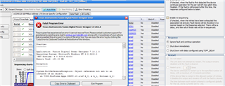

  • Hi Yihe
    I tried to set through GPI fault response after assigning the functionality.  but the tool crashes with fatal programming error, can you try it once on your setup.
    To set GPI to this.
  • HI
    Could you please try this
    TI-Fusion-Digital-Power-Designer-7.10.13.zip
    Yihe
  • Thanks Yihe with this tool option seems to be selecting without tool crash.
    So my understanding is that with GPI input low the UCD will trigger a resequence of all the rails now?
    based on GPI Fault response?
  • Hi
    GPI has the option to re-sequence all the rails and yes, it is based on the GPI fault response
    Yihe
