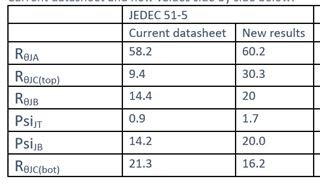

hi
the thermal parameters in the datasheet were not updated
the Junction to board is still smaller than junction to case.
hi
Hi Alex,
The thermal data on present data sheet was simulated with different definition. pls refer to the new data which refer to package bottom or the external board to mount the module. Sorry for the confusion.
