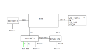

    4. block diagram of the design

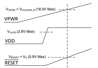

    1. There is a power sequencing issue occuring with your Vdd, Vpwr, and Reset pins which is keeping the device in a lockout state during these test conditions. I would recommend keeping Vdd low until Vpwr clears the UVLO condition prior. You can also keep reset pin low until Vpwr clear UVLO to ensure the UVLO latch is properly cleared.

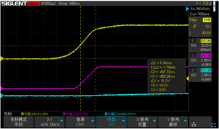

    1. The image shows the waveforms for VPWR (yellow), VDD (red), and RESET (green). Does this power-up sequence conform to the requirements?

    1. The power on sequence is correct. Thank you for the waveforms.
    2. Your understanding is correct, an MCU is required to load SRAM and configure the device to operate under normal conditions. MCU structure should be similar to the following:
