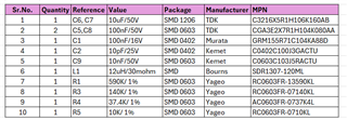

Below is the schematic of power supply on my custom board. I have connected potential divider on EN pin so that chip starts only when input voltage increases above 19V. One capacitor on input and output are DNP (Do not populate) so as to connect more caps if required for stability. I have observed chip blow up when these capacitors were connected or not connected.
Below is the BOM of passive components in my design. Active components part nos. are as mentioned in schematics.

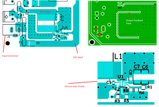

PCB layout was done following the guidelines given in datasheet.
Board images:
Please help me locate the issue.

  • I missed giving part nos. for C3 and C4 (47uf / 25V) in my previous post - C3216X5R1E476M160AC.

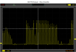

    The failure happens when hot-pulg-in right? Can you please measure the waveform of Vin, SW when hot-plug in ? And see if there is any overshoot/ voltage spikes.

  • Hi Gui,
    The failure happens at hot-plug in as well as when input supply is started. I am using SMPS from 'Meanwell', model no. LRS-75-24. I have already observed waveforms at the output of this power supply. The output of this power supply is quite clean and soft starting. I have not observed any overshoot on output of power supply.
    However, I have not checked at 'SW' pin of IC as I thought there is no load connected so this should not be problem. Do you want me to check waveform at SW pin? do we need any minimum load to be connected at output?

  • Hi Gui,
    Yes, issue is reproducing randomly but I do not have waveforms at the instant of IC burning out.

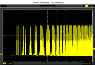

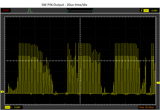

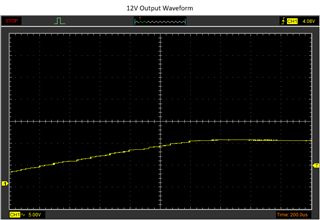

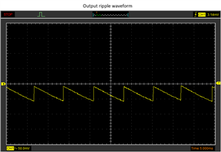

    Here are waveforms in normal operating condition without load.

    Can you please highlight the GND plane and connector in your board as well? Also during failure are you getting any current spike in your power supply? It may be good to check once with limiting the current through power supply or selecting a fuse with lower current rating.

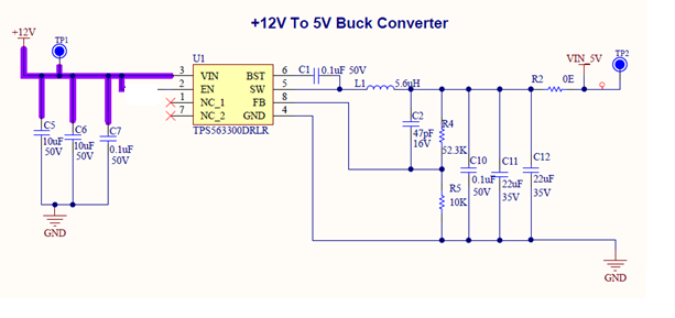

  • Hi Himanshu,
    There is no way for reverse supply. I am generating from 15V to 12V buck converter and it never get reversed. I am worry because our 200-pilot boards are already in production.
    Strange is that its input voltage never more than 12V. Do you think any TVS diode or any such protection will help?
    Hitesh Gambhava
  • Hi Hitesh,
    I am little confused here. Which IC/ICs are burning out? Are there multiple devices which are going bad?
  • Hi Himanshu,
    TPS563300 blowing out. I am mentionting that there is zero possibility of supply reversal in my case.
    Hitesh
  • And which is the circuit for which it is blowing up? Is it for 24V to 12 V stage or 12V to 5V stage or both?
  • It is at 12V to 5V stage.
    Hitesh
  • So there is no fuse or any kind of protection added on the input side? You may want to try with a fuse. Also, please share the correct waveforms, whatever waveforms and protection circuit you had shared earlier was for 24V to 12 V stage.
